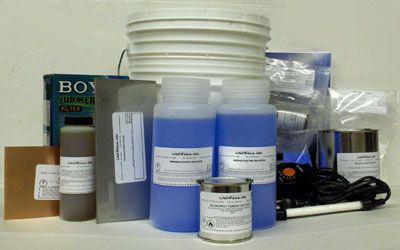

Now you can join the thousands of people that are bronzing baby shoes and similar objects, as a hobby or as a business, with our new Baby Shoe Bronzing Kits.
We offer two kits, a complete starter kit, which includes everything required to begin to bronze parts, or a mini kit, which includes the chemicals only, and assumes you already have such items as a DC power supply, airbrush, buffing materials etc.
The kits include 1.5 gallons of plating solution and 2 gallon tanks, large enough to plate 2 shoes at a time.
The kit can be used to bronze almost anything that is non-conductive, including baby shoes, plastic parts, leather items, fabric, flowers, plants, butterflies etc.

The Complete Starter Kit Includes:
  • 5 x 2 Gal Plastic Tanks and Lids
  • 1.5 Gallon Copper Crystals and Brighteners
  • 2 x Copper Anodes
  • 1.5 Gallon Bronze Plating Solution
  • 2 x Stainless Steel Anodes
  • 3 x Heaters
  • 2 x Agitation Pumps
  • 1 Pack of Degreasing Chemical
  • 8oz Silvaspray Conductive Paint
  • 2 Quarts Caswell Sealer Concentrate (Makes 1 gallon)
  • 8oz Bronzing Solution (Makes 4 gallons)
  • 1 x 5 amp DC Rectifier
  • 1 x Airbrush (you will require a small compressor)
  • 1 x 1/3 HP Buffing Machine, 3450 RPM
  • 3 x 6" Spiral Sewn Cotton Wheels
  • 3 x 6" Loose Cotton Wheels
  • 1 x Large Brown Buffing Bar
  • 1 x Large White Buffing Bar
  • 1 x Wheel Rake
  • 1 x Caswell Plating Manual
  • 1 x How To Buff and Polish Booklet
