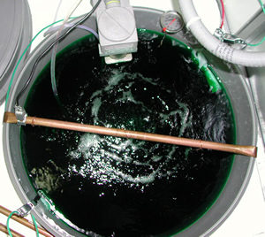

Kit comes with rectangular tanks 12W x 24L x 18H
This kit has been especially designed for the smaller workshop requiring high quality Chrome plating facilities for small to medium sized parts. It is ideally suited to operate as a small business venture, plating automotive and motorcycle parts.

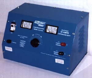

The kit is supplied with 2 rectifiers, the smaller one, a 25 amp capacity, is designed to operate the copper and nickel plating tanks, with a maximum capacity of approx 300 sq. inch surface area.
Amperage requirements for copper and nickel plating are approximately 1 amp per 15 square inches of surface area.
Rectifier
The larger rectifier, supplied by Aldonex Inc, is a 250 amp capacity, specifically designed to control the higher demands of the Chrome Plating tank. 250 Amp Rectifier
Amperage requirements of chrome plating are 1+ amps per square inch of surface area.
The 6 tanks supplied are constructed of HDPE, a chemical resistant plastic. They come with a lid to ensure tanks are completely safe and sealed when not in use. Dimensions are:- 12W X 24L X 18H
The kit comes with professional 1000W heaters, made by Clepco. Three titatanium heaters are included for the plating tanks, and a stainless heater is included for the degreasing tank. The heaters feature digital control boxes, which plug directly into your 110V mains circuit. No special wiring is required.
Nickel, Flash Copper™ and Chrome all plate at 110°F. Acid Copper plates at 70°F and should not require heating unless the bath is in a cold room. If so, you should consider purchasing a 1000W Quartz heater.
